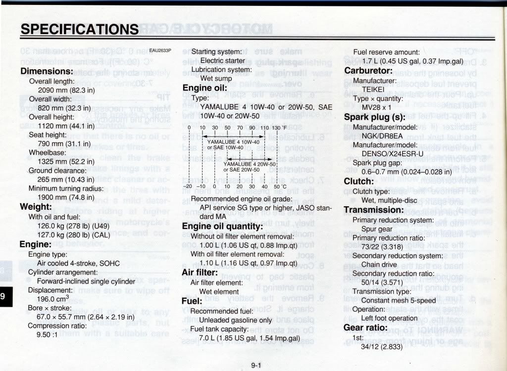

I checked my manual for my 2009 TW and it shows 20-50 for summer temps.

What page?
This is 2008 manual - My 2007 is the same...

I just checked my 09's manual and it does indeed have  20-50 on it. Good eyes ordinaryguy  :)

Okay, I spent the last few hours comparing 2007 and 2010 part numbers (as well as building myself a complete Parts Fiche document) and all looks good.
20w50 will be fine an all TW's - So I now stand corrected!
